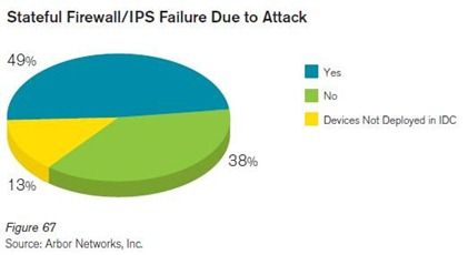

This same lesson can be applied to removing the firewall from the critical inbound data path of services. Sure, it sounds unnatural and perhaps it is if it’s the first time you’re trying it, but necessity is the mother of invention and seems to also help overcome the feeling that something shouldn’t be done because it hasn’t been done before. If you need convincing as to why you might consider such a tactic, consider a recent survey conducted by Arbor Networks showing an increasing failure rate of firewalls and IPS solutions due to attacks.
“Eighty-six percent of respondents indicated that they or their customers have placed stateful firewall and/or IPS devices in their IDCs. Nearly half of all respondents—a solid majority of those who actually have deployed these devices within their IDCs— experienced stateful firewall and/or IPS failure as a direct result of DDoS attacks during the survey period. Only 14 percent indicated that they follow the IDC BCP of enforcing access policy via stateless ACLs deployed on hardware-based routers/Layer 3 switches capable of handling millions of packets per second.”[emphasis added]
>-- Network Infrastructure Security Report Volume VI, Arbor Networks, Feb 1 2011
That is a lot of failures, especially given that firewalls are a critical data center component and are almost certainly in the path of a business critical web or application service.
