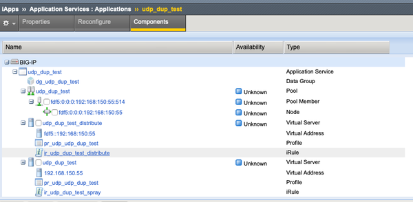

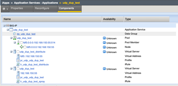

  • If you ever need an iApp based on this template to duplicate traffic to virtual servers instead of to pool or nodes. Below is the procedure I used.
    Create an iApp with dummy values for the “Destination Server Questions” section during creation

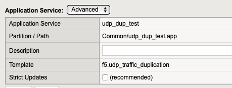

    Uncheck the strict updates on the iApp to make manual changes

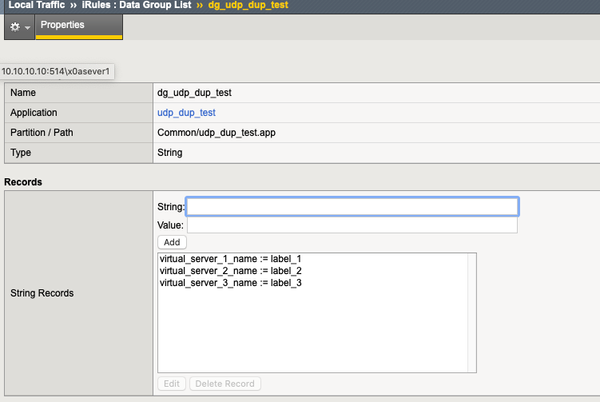

    Replace the dummy string records created by the iApp in the data gorup with the virtual server names that you want the traffic to be duplicated to. The label values will not be used
    Data group string records should look like this

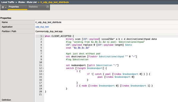

    Change this iRule (name should be ending with “_distribute” ) with the one below
    when CLIENT_ACCEPTED {
                   binary scan [UDP::payload] ssssa256a* a b c d destinationwithpad data
                   #log "sending from $a.$b.$c.$d to pool: $destinationwithpad"
                   UDP::payload replace 0 [UDP::payload length] $data
                   snat "$a.$b.$c.$d"
                   #get just dest without pad
                   set destination [findstr $destinationwithpad "" 0 "~"]
                   #log $destination
                    set nodeandport [split $destination ":"]
                   virtual [lindex $nodeandport 0]
    Duplicated traffic would be sent to the virtual server name listed on the data group
