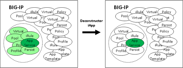

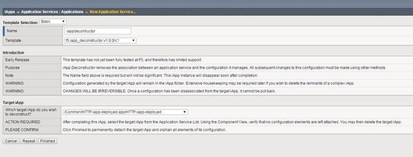

f5.iapp_deconstructor is for customers who want to free a configuration from the iApp that created it. It is possible to remove the app-service property from objects created by an iApp manually, but it is quicker and easier to use this tool. It allows the user to strip the app-service property from hundreds of configuration objects in one simple step. Simply choose the target iApp from a dropdown menu and click "Finished." Be aware that this action cannot be undone.

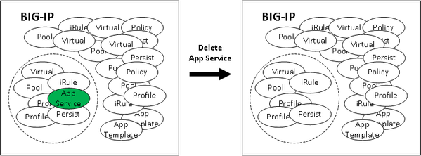

The resulting "empty" ASO may then be removed, leaving the other configuration elements in place.

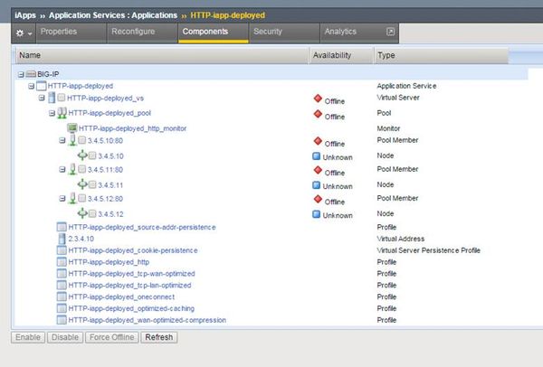

Before:
iApp Deconstructor

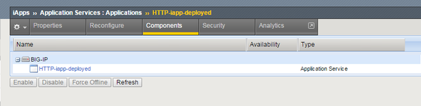

After:
