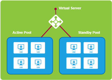

Topology:
Requirements:
  • There are two pools configured (Pool_A & Pool_B)
  • The members of each pool will work using Round Robin LB method.
  • One pool will act as active and the other one will be in standby mode.
  • Only the pool with active role will be able to process traffic.
  • If 2 or more members of Pool_A (initially active) are down, Pool_B (initially standby) asumes the role of active.
  • There is no preempt, in case of Pool_B asumes the active role, it will be active until someone decide to roll back to the initial situation (manually).
