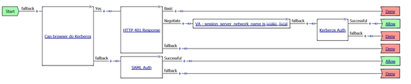

The screenshot below shows an example of an Access Policy that uses either Kerberos or SAML authentication.

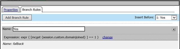

The first agent in the policy is an 'Empty Agent' which will read the session.custom.domainjoined variable to determine which authentication method to use. The session.custom.domainjoined variable is set by the kerberos_auth_or_fallback_auth iRule.
