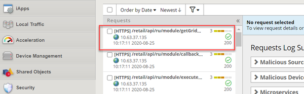

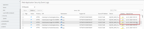

We have BIG-IQ system. But At this time WAF event log on BIG-IQ not real -time
We have check event log on BIG-IP Device all ok. But on BIG-IQ not real -time
Plz help me
BIG-IQ: Time: Last Event log: July 21,2020
BIG-IP: Device: always real time
Thanks all
Event Log BIG-IQ
Event Log BIG-IP

  • Hello Hoang,
    Do you have different time for the same "Support ID"?
    Do you configure dns and ntp on BIG-IP and BIG-IQ?
    Thanks, Ivan

        For each request, which is logged on BIG-IP/BIG-IQ you have Support ID (id of logged request).
        On your screenshot from BIG-IQ it is mentioned in "Support ID" column.
        On BIG-IP it could be seen in "All Details" of selected request, also you can use filer to find needed one.

    Check the time of Support ID *6091 on BIG IP. To validate the right time
    • Hi
      I have check support ID *6091 on BIG-IP but It is not have on BIG-IP. I have check , log on BIG-IQ depend on other Policy. and now on BIG-IP havent policy it.
      ==> So I cannt find it.

    I have check on BIG-IQ. I see that:
    In Configuration > Security > WAF >Virtual Server: I see that: Virtual Server applied Policy WAF inactive. But
    Configuration >Local Traffic > Virtual Server : It's still with Active.
    ===> I think ===> No event log on BIG-IQ.

    • Ivan_Chernenkii's avatar
      Ivan_Chernenkii
      Hello Hung,
      It looks like your BIG-IP and BIG-IQ are out of sync - you have VS with policy and logging profile on BIG-IP, but not on BIG-IQ, that is why on BIG-IQ you don't see any logs anymore.
      I suggest to create needed configuration on BIG-IQ and then deploy it to all appropriate BIG-IPs.
      About inactive policy - you need to make it active.. Do you know how?
      Thanks, Ivan

        I suggest to create needed configuration on BIG-IQ and then deploy it to all appropriate BIG-IPs. : I degree.
        But. and now Virtual Server on WAF: inactive so we can not deploy from BIG-IQ to BIG-IP
        (Note: On Virtual Server ( Local Traffic) BIG-IP and BIG-IQ still Activc (Previous picture)
        Ivan: " About inactive policy - you need to make it active.. Do you know how? " At this time I not solution it yet"
        Do you know how ?

  • Hi
    Yep .Currently I see requests logged on BIG-IP, but not on BIG-IQ.
    I have congfig remote log profile, then attached it to VS.
    I sent to you information detail attach picture.
    Thanks
