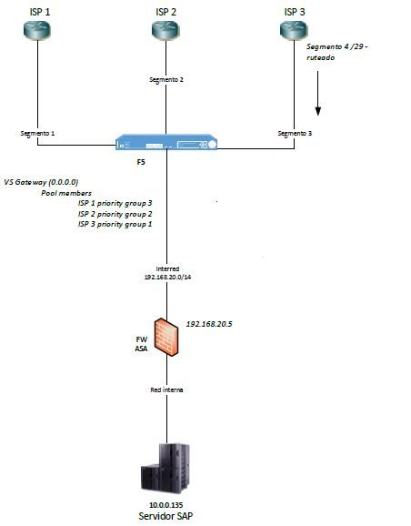

Hi, i have the next situation:
Internet -> F5 LC -> Cisco ASA
I understand that 2 VS must be configured, 1 for incoming traffic and 1 for outbound traffic:

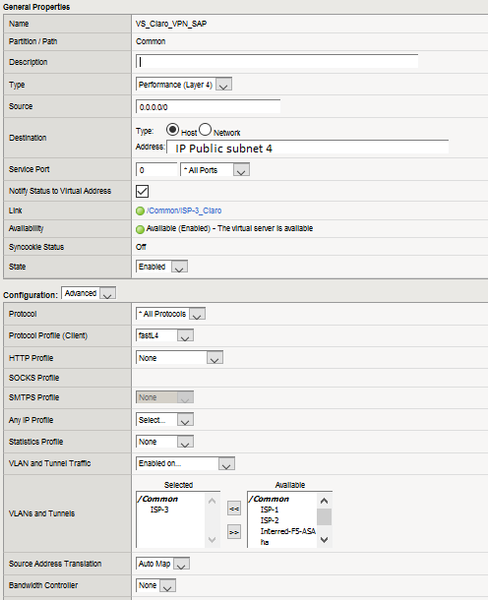

VS incoming traffic:
Performance Layer 4, destination host -> public IP (a.a.a.a), service port 0, all protocols

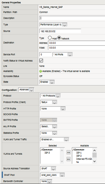

VS outgoing traffic:
Performance Layer 4, source -> b.b.b.5 (interface LAN of Cisco ASA), destination 0.0.0.0/0, service port 0, all protocols, source address translation SNAT -> SNAT_pool (Public IP VS a.a.a.a) pool member -> 3 ISP with preference
Is this enough or do I need something else to establish communication? I must mention that I already have a VS output to the internet with the 3 ISP source LAN (b.b.b.0/24) destination network 0.0.0.0/0 all protocols .... will there be any problems?

    VS Outgoing traffic: -> Cisco ASA F5 LC -> Internet

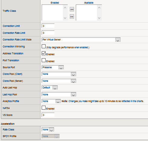

    For this VS don't forget to uncheck "Address Translation" and "Port Translation" in VS settings. an L4 Vs is OK.

    VS incoming
    VS outgoing
    snat pool -> member (IP Públic in VS incoming)
