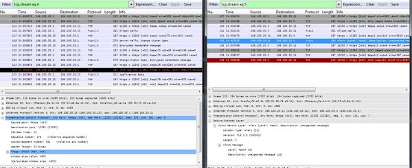

It has made the following screenshots for sulucion the problem:
It has generated two scenarios for the solution of the problem. This consisted of changing the IP address of the virtual server.
Scenario 1:
IP address of the firewall: 196.100.20.1
Self IP - F5: 196.100.20.5
Virtual server: 196.100.20.15
Pool Member (Servers OAS - Oracle): 196.100.20.11:443, 196.100.20.12:443
File captured in this scenario: sslfail0712.cap
tcpdump-ni 0.0: nnn-s0 host 196.100.20.11 172.16.1.27 or 196.100.20.15 host 196.100.20.12 host or host-or w / var/tmp/sslfail0712.cap
tcpdump executed in the following error was encountered:

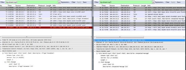

Scenario 2:
Virtual server: 196.100.20.6
In this second scenario this option is configured in your SSL virtual Server profile (clientssl and serverssl).
DEFAULT: TLSv1_2: TLSv1_1: SSLv3
I do change because apparently in the initial capture (tcpdump) had noticed the changing TLS TLS V1.2 to V1.0
File captured in this scenario: sslfail0714.cap
tcpdump-ni 0.0: nnn-s0 host 196.100.20.11 172.16.1.27 or 196.100.20.6 host 196.100.20.12 host or host-or w / var/tmp/sslfail0714.cap

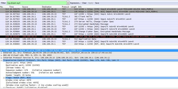

But after the change I found these two errors:
After these changes the abovementioned problem persisted.
