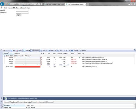

VIP address gets member port appended in URL
Yes, I'd check for response content that refers to the webserver port. You can either modify the server config to reference itself with the public facing port or use an iRule to rewrite the response headers and/or payload from the server port to the public facing port.
Here's an example to rewrite the server port: https://devcentral.f5.com/wiki/iRules.RewriteHTTPRedirectPort.ashx
To rewrite the response payload, you can use a stream profile and STREAM::expression based iRule:
https://devcentral.f5.com/wiki/iRules.stream__expression.ashx
