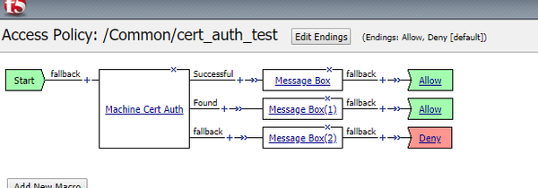

I have the following simple policy:

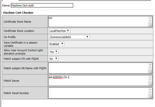

With the following Machine Cert Auth Config:
Here I have tried numerous of different combinations. The one I'm presently using is this:
CN=ad-ADDS01-CA-2, DC=ad, DC=jonsson, DC=biz

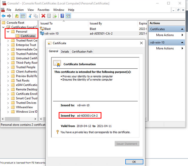

I have installed the following computer cert on the computer trying to connect:

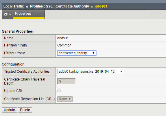

I have configured a Certificate Authority Profile with the following settings:
That is the root CA which has signed the Computer certificate.

    Your CA "adds01" is the root of you PKI hierarchy ? Or is it itslef signed by another ROOT CA ?
    If it is a sub CA, import also the root in the CA profile, this should help.
