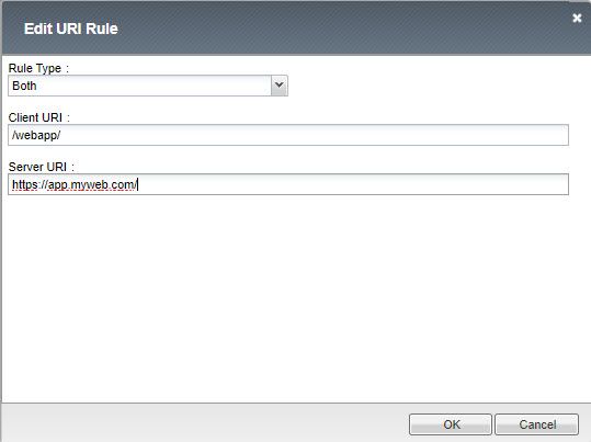

Then i tried it with an rewrite profile
 Does anyone have any idea what I'm doing wrong?
