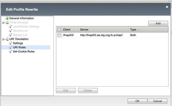

I need to set up a URL redirect. For example, if i enter in the browser:
newstage.domain.com/server1 then I want that request to go to server1.local.com.
I have read in the following article:
https://techdocs.f5.com/kb/en-us/products/big-ip_ltm/manuals/product/ltm-implementations-12-1-0/17.html
That this can be done using "Rewrite profile" I have created my Rewrite Profile, attached it to my VS but it is not working.
Anyone else know how i can get this done?
Thank You

    Would you be able to share the configurations of the virtual server and the rewrite profile here?

    Sure, for the Virtual Server the settings are pretty standard:
    Type: Standard
    Source Address: 0.0.0.0/0
    Destination Address/Mask: 192.168.25.54
    Service: 443 HTTPS
    Protocol: TCP
    Protocol Profile (Client): tcp-wan-optimized
    Protocol Profile (Server): tcp-lan-optimized
    HTTP Profile: http
    VLAN and Tunnel Traffic: All VLANS and Tunnels
    Source Address Translation: Auto Map
    Rewrite Profile: my_proxy_profile
    HTML Profile: html
    As for the Rewrite Profile, i have attached a screen shot to this post.
    Thanks
  • Hi,
    perhaps the question is still open?
    For testing I'm using a virtual server on a 2nd BIG-IP (might be located on the same BIG-IP and addressed via iRule "virtual" command.
    The iRule returns the internally seen parameters (as modified by the rewrite profile):
    when HTTP_REQUEST {
       set internal_domain  [join [lrange [split [getfield [HTTP::host] ":" 1] "."] 1 end] "."]
       HTTP::respond 301 \
           content " \
               internal host  : [getfield [HTTP::host] ":" 1]\r\n \
               internal path  : [URI::path [HTTP::uri]]\r\n \
               internal base  : [URI::basename [HTTP::uri]]\r\n \
               internal query : [HTTP::query]\r\n \
               internal domain: ${internal_domain}\r\n" \
           noserver \
           Content-Type "text/plain" \
           Location https://[HTTP::host][HTTP::uri] \
           Date [clock format [clock seconds] -format {%a, %b %d %Y %H:%M:%S GMT} -gmt 1] \
           Set-Cookie "TrackingMe=[format %09d [expr int(rand()*1e9)]]; Domain=${internal_domain}; Path=[URI::path [HTTP::uri]]" \
           Connection Close
    The rewrite profile and the virtual server on the device under test looks as follows:
    ltm virtual vs_test-rewrite_443 {
        destination 10.131.131.53:443
        ip-protocol tcp
        mask 255.255.255.255
        pool pool_rewrite-test
        profiles {
            clientssl-secure {
                context clientside
            http2 { }
            http { }
            profile_test-rewrite { }
            serverssl {
                context serverside
            tcp { }
    ltm profile rewrite profile_test-rewrite {
        bypass-list none
        client-caching-type cache-css-js
        defaults-from rewrite
        java-ca-file ca-bundle.crt
        java-crl none
        java-sign-key default.key
        java-sign-key-passphrase-encrypted none
        java-signer default.crt
        location-specific false
        request {
            insert-xforwarded-for enabled
            insert-xforwarded-host enabled
            insert-xforwarded-proto enabled
            rewrite-headers enabled
        response {
            rewrite-content enabled
        rewrite-list none
        rewrite-mode uri-translation
        set-cookie-rules {
            cookie_1597831515516 {
                client {
                    domain lb-net.bit
                    path /prefixext/
                server {
                    domain lb-net.internal
                    path /prefixint/
        split-tunneling false
        uri-rules {
            uri_1597822570761 {
                client {
                    path /prefixext/
                server {
                    host test.lb-net.internal
                    path /prefixint/
                    scheme https
    Testing with cURL returns the expected results:
    $ curl -svk https://test.lb-net.bit:443/prefixext/test.label/object?query=test --resolve test.lb-net.bit:443:10.131.131.53
    * Added test.lb-net.bit:443:10.131.131.53 to DNS cache
    * Hostname test.lb-net.bit was found in DNS cache
    *   Trying 10.131.131.53...
    * Connected to test.lb-net.bit (10.131.131.53) port 443 (#0)
    * ALPN, offering h2
    * ALPN, offering http/1.1
    *        SSL certificate verify result: self signed certificate (18), continuing anyway.
    * Using HTTP2, server supports multi-use
    * Connection state changed (HTTP/2 confirmed)
    * TCP_NODELAY set
    * Copying HTTP/2 data in stream buffer to connection buffer after upgrade: len=0
    * Using Stream ID: 1 (easy handle 0x1735150)
    > GET /prefixext/test.label/object?query=test HTTP/1.1
    > Host: test.lb-net.bit
    > User-Agent: curl/7.47.1
    > Accept: */*
    * Connection state changed (MAX_CONCURRENT_STREAMS updated)!
    < HTTP/2.0 301
    < content-type:text/plain
    < location:https://test.lb-net.bit/prefixext/test.label/object?query=test
    < date:Wed, Aug 19 2020 12:48:04 GMT
    < set-cookie:TrackingMe=480369567; Domain=lb-net.bit; Path=/prefixext/test.label/
      internal host  : test.lb-net.internal
      internal path  : /prefixint/test.label/
      internal base  : object
      internal query : query=test
      internal domain: lb-net.internal
    Both redirect (host and path) and the cookie domain and path set by the server are properly rewritten.
    The setup above was tested on TMOS v12.1.4.1 with HTTP/1.1 and HTTP/2.
    Be aware, that a stream profile and disabled serverside compression might be required as well to replace references in the payload.
    The rewrite profile above just modifies the http-protocol data but not the the delivered payload.
    Cheers, Stephan
