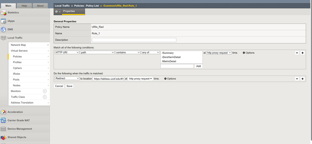

    • msaud's avatar
      msaud
      Icon for Cirrus rankCirrus
      Thanks for your support.
      I think we should go for "you can do it using LTM policy it will be much easier "
      • Okay dear msaud  ,
        you can configure it like this way :
        No need to add host names , as I assume that this virtual server hosts only one hostname.
        Try it and let me know
