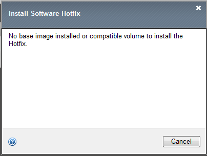

I just tried installing Hotfix-BIGIP-11.5.1.5.0.147-HF5.iso onto the LTM with 11.3. I received the error below. It looks as though I will need a base image after all which leaves me back to my original concerns of backing out to version 11.3 if I have application issues on 11.5.1. Any thoughts?
not sure how this is going to turn out, it don't see anything except for your original question.
anway, two things are important
the software, you need the base images and hotfix uploaded to your big-ip. you need both.
the volume, you install a base image or hotfix in a volume. you can install a hotfix, the system will first install the base image and then the hotfix in the same volume. this can be done on any volume except the active one. at this stage nothing changes to your big-ip, everything keeps on running.
once you reboot in that other volume only then it becomes active. if you have issues you can always boot back in the previously active one.
that is all that should matter in my opinion.
- mnb_63148
That worked. I had assumed that the base image had to be installed to a volume in order to apply a Hotifx. However, I only had to import the base image so that it showed under the Available Images section and not install it. After importing the base image, I was able to install the Hotfix.
