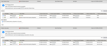

Thank you for the hints! I've followed some actions described in ID882609 , though it wasn't exactly the situation I had. Specifically one of the devices failed to correctly restart tmm: bigstart restart tmm. That started spawning the following message each two seconds: Re-starting mcpd
I restarted that second device and did tail -f /var/log/tmm on both hosts.
First device
Sep 2 13:55:11 bigip2.xx.yyyy notice mcpd[6967]: 01b00004:5: There is an unfinished full sync already being sent for device group /Common/Sync-Failover-Group on connection 0xea1726c8, delaying new sync until current one finishes.Second device with sync issues contained end_transaction message timeout
Sep 2 13:45:10 bigip1.xx.yyyy notice mcpd[7158]: 01070430:5: end_transaction message timeout on connection 0xe685c948 (user %cmi-mcpd-peer-10.13.13.132) Sep 2 13:45:10 bigip1.xx.yyyy notice mcpd[7158]: 01070418:5: connection 0xe685c948 (user %cmi-mcpd-peer-10.13.13.132) was closed with active requests Sep 2 13:45:10 bigip1.xx.yyyy notice mcpd[7158]: 0107143c:5: Connection to CMI peer 10.13.13.132 has been removed Sep 2 13:45:10 bigip1.xx.yyyy notice mcpd[7158]: 01071432:5: CMI peer connection established to 10.13.13.132 port 6699 after 0 retries Sep 2 13:50:10 bigip1.xx.yyyy notice mcpd[7158]: 01070430:5: end_transaction message timeout on connection 0xe685c948 (user %cmi-mcpd-peer-10.13.13.132) Sep 2 13:50:10 bigip1.xx.yyyy notice mcpd[7158]: 01070418:5: connection 0xe685c948 (user %cmi-mcpd-peer-10.13.13.132) was closed with active requests Sep 2 13:50:10 bigip1.xx.yyyy notice mcpd[7158]: 0107143c:5: Connection to CMI peer 10.13.13.132 has been removed Sep 2 13:50:10 bigip1.xx.yyyy notice mcpd[7158]: 01071432:5: CMI peer connection established to 10.13.13.132 port 6699 after 0 retriesThat error message lead me to K25064172 and K10142141 despite I'm not running in AWS, my VmWare Workstation used vmxnet3 driver and I tried to switch to sock as suggested in that KB.
[root@bigip1:Standby:Not All Devices Synced] config # lspci -nn | grep -i eth 03:00.0 Ethernet controller [0200]: VMware VMXNET3 Ethernet Controller [15ad:07b0] (rev 01) 0b:00.0 Ethernet controller [0200]: VMware VMXNET3 Ethernet Controller [15ad:07b0] (rev 01) 13:00.0 Ethernet controller [0200]: VMware VMXNET3 Ethernet Controller [15ad:07b0] (rev 01) 1b:00.0 Ethernet controller [0200]: VMware VMXNET3 Ethernet Controller [15ad:07b0] (rev 01) [root@bigip1:Standby:Not All Devices Synced] config # tmctl -d blade tmm/device_probed pci_bdf pseudo_name type available_drivers driver_in_use ------------ ----------- --------- --------------------- ------------- 0000:03:00.0 F5DEV_PCI xnet, vmxnet3, sock, 0000:13:00.0 1.2 F5DEV_PCI xnet, vmxnet3, sock, vmxnet3 0000:0b:00.0 1.1 F5DEV_PCI xnet, vmxnet3, sock, vmxnet3 0000:1b:00.0 1.3 F5DEV_PCI xnet, vmxnet3, sock, vmxnet3The fix for VmWare is
echo "device driver vendor_dev 15ad:07b0 sock" >> /config/tmm_init.tclAnd after I have restarted both nodes I saw the desired "In Sync" status.
What is interesting enough that I got this issue on two separate computers running the same VmWare Workstation version. I also reinstalled three different versions of BigIP and always got the same result. Another crazy thing is that if instead of Sync-Failover I would create Sync-Only group, there were no issues at all. It should be some compatibility issue I think.
