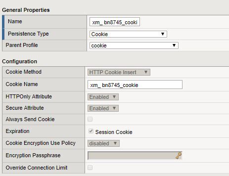

  • hi, below the VIP config and a image from the cookie persistence profile

    Ok, this is one big-ip only. 1) It is not clear if you you facing the issue on public vip only or on both of them. 2) The cookie is valid for session only. It means that, if you close your app on the client side, next time new session will use another pool member.
    By telling "if we do some upload test from the same source, we always land on different web server. " do you mean you close the application, open it and upload again?

  • hi surgeon no, we don't close the application. for testing we used a gallery application with an in-memory queue on each web server. the user uploads 16 picture at the same time, so all of the pictures have to land on the same web server.
