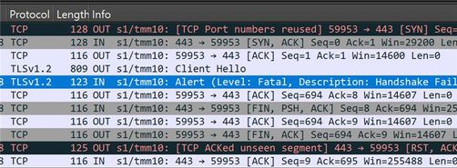

Hi guys
TLS is weird.
Why is this behavior happening?

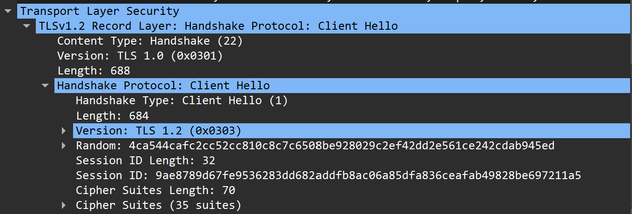

The server that receives the client hello sends an alert.
Transport Layer Security TLSv1.2 Record Layer: Handshake Protocol...

I don't know anything about the server-side configuration other than that it only supports TLS 1.0.
The above is a TCP packet dump. Do you know what causes these packets to appear?
