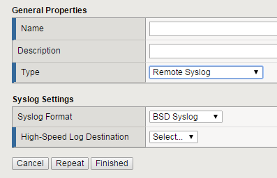

Thanks a lot Jason. I am forced to use High-speed logging? (So I cannot use the management interface to send logging traffic?)?

- SANTS_boy_18328
Thanks Jason, but when you press remote syslog, you are forced to put the High Speed Syslog afterwards.
How can I over pass this?

- JRahm
Admin
Right..but that just means you are using HSL under the hood of BIG-IP, if you select syslog formatting, it won't just be the RAW format typical of HSL. All that's required for that is to define a pool (can be one member->your syslog server) and then select it as your destination - SANTS_boy_18328
