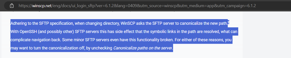

  • probably it is related to the path canonicalization.
    default is auto in winscp but you can try to disable it.
