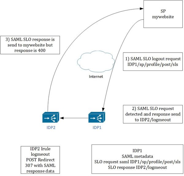

I have the following requirement to modify the SAML response data in particular the SLO destination. The goal here is to finalize the end user session on both the SP mywebsite, IDP1 and IDP2 (this is a chained setup). With this config the session is being terminated on the IDP1 and IDP2 but still not on the SP, this is because the IDP1 sends the SAML SLO response to IDP1 with the SLO destination being IDP1/logmeout, when resending the POST request via redirect to end user and direct it back to mywebsite it reponds with 400 BAD requests, this is because of the SAML SLO data contains the old IDP/logmeout destination and need to be modified.

    this is because the IDP1 sends the SAML SLO response to IDP2 with the SLO destination being IDP2/logmeout

    I created the following Irule on IDP1 to detect the SLO request, bypassing the local IDP from processing the SLO request and forwarding it to IDP2/logmeout. The POST SLO request is being received at the IDP2 and again being redirected back to IDP1, before that I insert the referer header as the query to be able to differentiate the request and guess what it is working, BUT because of the ACCESS::restrict_irule_events disable the IDP1 is not processing the SLO request to be able to send the SAML SLO response back to the SP.

    The following Irule works when the logout SLO request comes back to IDP1 for generating the SLO respons we modify the uri by removing the appended query and Access Policy now accepts the requests and send the SLO response back to the SP. This way both IDP and application are logged out correctly.
