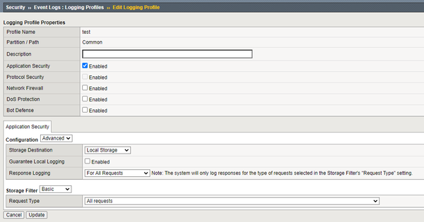

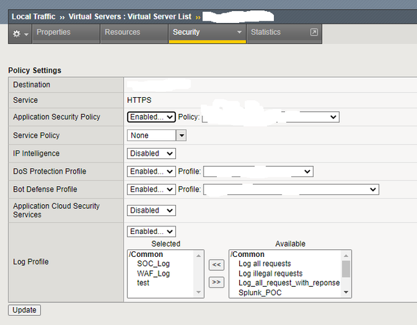

Hi all,
My Big IP ASM version is 16.1.0.
I have followed step by step in this guide link to enable response logging (https://devcentral.f5.com/s/question/0D51T00007Mzb1U/how-to-enable-response-logging-in-waf)
- Create logging profile
- Map this logging profile with virtual server
But after update and check in event log, I still get notification is Response N/A (Response logging was disabled)
Please help me to solve it with many thanks

Hi Ngô Minh Quân,
Can you run the commands?
pkill -f asm_config_server pkill -f asmlogd pkill -f pabnagdThis commands will not impact the network traffic.
