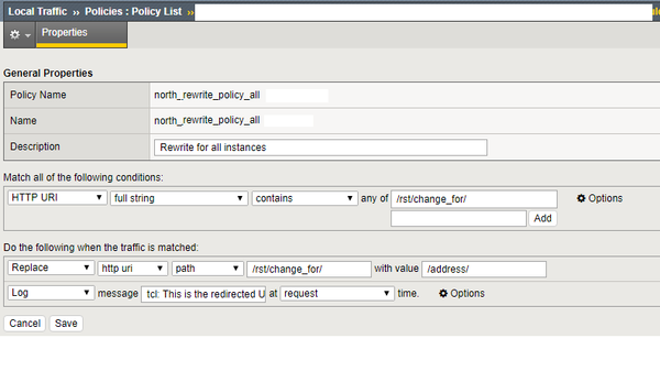

Replace Part of the Path in URL using LTM Policy
Hi,
I have created LTM Policy(Local Traffic>>Policies>>Policy List) to replace a part in the URL.
Requested URL: https://www.test.com/xyz/rst/change_for/test/index.refresh
Replace /rst/change_for/ with /address/
Expected Request from F5 to backend server is: https://www.test.com/xyz/address/test/index.refresh
How do we achieve this through LTM Policy I tried few options As per the attachment, but it did not work.
Note: I need to achieve this through only LTM Ploicy( Not through iRule), also we have to replace a part(redirect should not happen)
Thanks, Siva.

  • Hi,
    Have you tried to replace the complete path instead of just a part of the path?
    So replace /rst/change_for/test/index.refresh with /address/test/index.refresh
    Regards, Martijn

    Hi Martijn,
    Thank you for your comment, we have created a new case, as this case is old and our situation is a little different.
    https://devcentral.f5.com/questions/replace-part-of-a-url-path-using-ltm-policy-60950
    In response to your question; The URL can change, so in our case, there are dates in the complete URL. So what ever comes after the parts we need to look for and change, needs to stay intact. Otherwise we could indeed do a complete rewrite of the URI.
