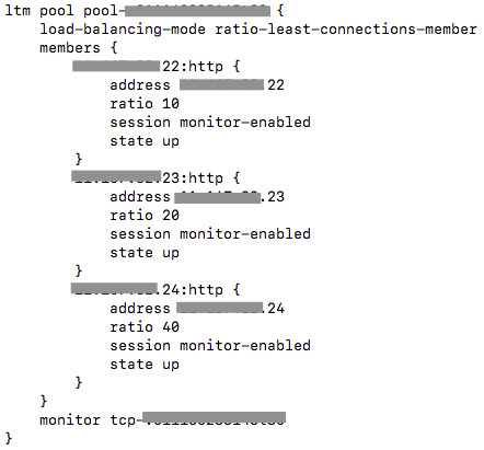

Hi All,
I set up a pool with ratio-least-connections-member LB mode and assign different ratios to pool members. But from a simple curl test it looks like LTM didn't distribute traffics based on it's LB mode, it behaved just like round-robin.
Did I misconfigure something?
I'm using F5 LTM VE, 13.1.1.2.
pool setting
test result
Thanks.

  • Well, I labbed out your situation and I have the same issue. It seems as if "least connections" takes precedence over "ratio".
    As soon as I changed my LB method to "Ratio (member)" the LB acted properly and heeded my ratios.
    As soon as I change it back to "Ratio Least Connections (Member)" it goes back to 50/50 between my two vips.
    My only advice would be to change your LB method to just "Ratio (member)"
    (my lab version was 13.1.1.3)
    -Dylan

  • I never played with ratio least connection member algorithm, but it seems it is like that:
    It evaluate number of connection * member ratio, then do the same as least connection
    If you do tests with only one curl, when the request is ended, connection closes, so number of connection for each member equals 0
    Least connection algorithm do round robin on all member matching same connection number
