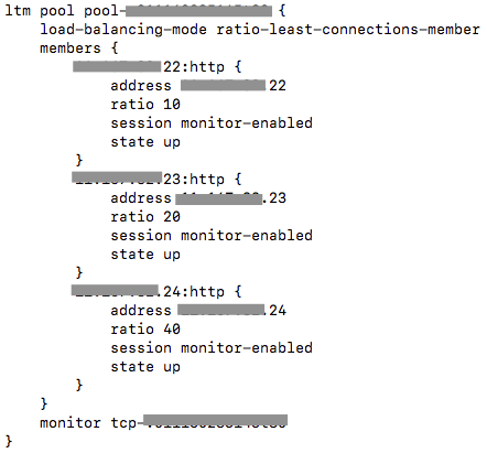

Hi All,
I set up a pool with ratio-least-connections-member LB mode and assign different ratios to pool members. But from a simple curl test it looks like LTM didn't distribute traffics based on...

Try this:
- Keep 2 pool members active.
- Give ratio is 10 and 30. (basically 1:3)
- Reset the stats.
- curl -v -k [1-1000]<<<<<<<<<<<<
- The curl command will generate 1000 requests, however current connection would be just 4 on bigIP.
- Check the stats again.
Worked for me.

7 years agoThanks Raman. It worked for me as well!
