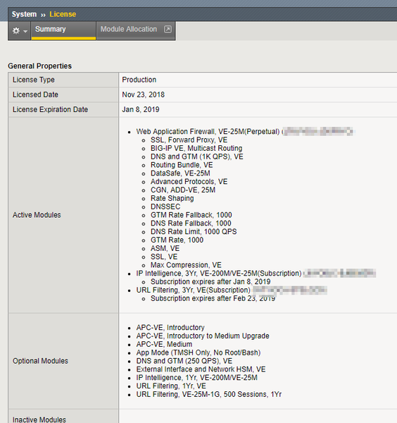

I actually went back to the licensing bits since the table states "Base VE as AWAF". I managed to find one named "WAF". So I deployed a completely new BIG-IP and used that license instead. Now I still cannot select AWAF and based on Nathans reply and my previous suspicion, I should provision the ASM module.

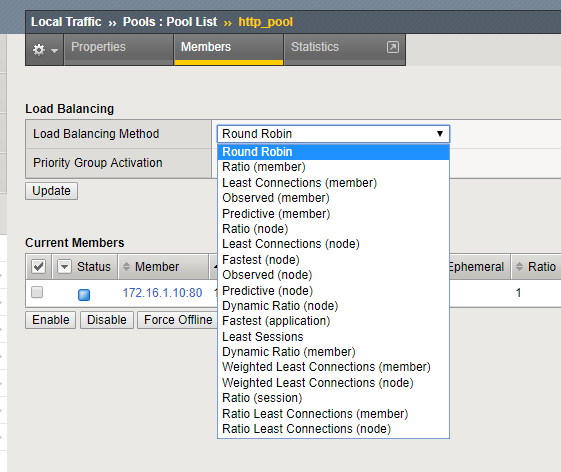

With only ASM provisioned, it still does not seem that I have provisioned "AWAF" since I'm not limited in terms of load balancing options. I should only be able to select this:
Load balancing methods supported:
- Round Robin
- Ratio (member)
- Ratio (node)
- Least Connections (member)
- Least Connections (node)
- Weighted Least Connection (member)
- Weighted Least Connection (node)
- Ratio Least Connection (member)
- Ratio Least Connection (node)
I got the following options:
Here is the new license:
So this does not have anything related to LTM. This does not make any sense haha

But the strange thing is that I should be not allowed to use Observed LB method amongst some other but they still appear in both BIG-IPs. One running a Web Application Firewall license with only ASM provisioned and a BIG-IP LTM license running only ASM.

Yeah, that is exactly what I mean. I got the impression that AWAF has many features from the LTM but not all of them and the load-balancing bits are quick way of detecting that. I found the following article, specifying that additional load balancing methods have been added:
New in 13.1.0.2 :: ASM Starting with BIG-IP 13.1.0.2, the following LTM features are available in Advanced WAF (AWAF):Load Balancing: No limit on IP pool members number
- Round Robin
- Ratio (member)
- Ratio (node)
Persistency:
- Cookie Persistency
- Source Address
- Host
- Destination Address
Release Note: BIG-IP 13.1.0 New Features and Installation
I have not seen an article where they have added Observed, Fastest or Predictive so naturally they should not be available in AWAF. I have tried both ASM provisioned BIG-IP with an AWAF license and an ASM priovisioned BIG-IP formed out from an LTM license with best bundle upgrade and additional AWAF license.
When checking persistence I have all options available as well. So it feels pretty odd and like I'm using a regular LTM box.
Both BIG-IP systems are running 13.1.1.2 and release notes in 13.1.1.2 does not specify anything different. So it feels like I'm running a full LTM with only AWAF/ASM provisioned and it does not seem right according to the documentation.
