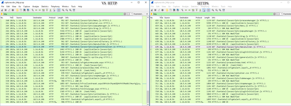

I have made captures in both scenarios by setting my virtual server on 443 and comparing with the capture with port 80 and I receive this:
the one on the left is the traffic when the virtual server espuerto 80 and the one on the right 443, this capture is the client side 1.16.0.56 -> vs 10.5.8.188

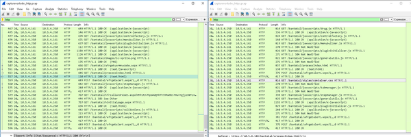

, this capture is the server side - the one on the left is the traffic when the virtual server espuerto 80 (works) and the one on the right 443 (does not work) 10.5.4.250 (snat) -> vs 10.5.4.161 (node)
for both cases the pool member always listens in 80 that changes only is the virtual server to 443 and does not work, I see messages of 304 not modified, I don't know if it has anything to do with the error
