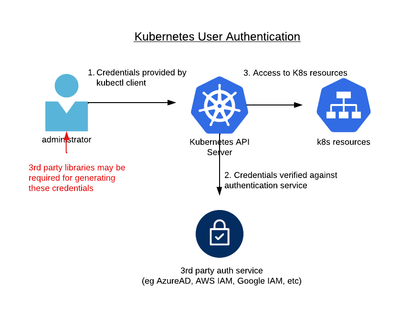

Accessing the K8s cluster API requires authentication, which can be configured following multiple authentication schemes. Commonly, at least two methods are used at once:
  • service account tokens for service accounts
  • at least one other method for user authentication
Hosted K8s providers, such as AKS, EKS, or GKE, commonly use an authentication plugin. Users will authenticate to the cluster via AzureAD, AWS IAM, or GKE IAM, respectively. For this to happen, the client (ie, kubectl) may need to provide an authentication token for this 3rd party auth service.
It is common for a third party library to be required on the kubectl client for this token generation. I've covered this in more depth in a previous article, but an admin of an EKS or GKE cluster may see that their kubeconfig file requires the kubectl client to execute the aws cli, the aws-iam-authenticator library, the gcloud cli, or the gke-gcloud-auth-plugin library.

There are two main problems here:
  1. Those libraries are not present on F5 XC Customer Edge (CE) nodes, which is where service discovery is run in F5 XC, and
  2. Even if those libraries were present, you would need to store your AWS IAM or GKE IAM credentials along with your kubeconfig file in order to authenticate to K8s.

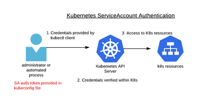

I'll quote the official documentation when suggesting an alternative:
"Service account bearer tokens are perfectly valid to use outside the cluster and can be used to create identities for long standing jobs that wish to talk to the Kubernetes API."
For the reasons above, I suggest creating a Kubernetes ServiceAccount (SA) with a custom ClusterRole, extracting the default bearer token for authenticating as this SA, and creating a kubeconfig file to allow F5 XC to use this SA and ClusterRole in service discovery.
