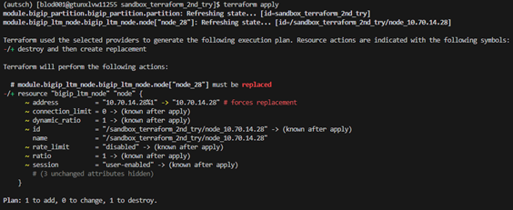

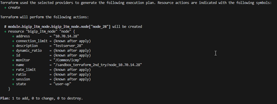

1.    I have created a node with the Terraform resource bigip_ltm_node:
So far, so good.
2.    Than I have started a “terraform apply” without any changes, but the Terraform is always claiminig that the ip address is configured with an “%1” at the end and wants to remove the “%1”, which is not possible.
The information about the ip with %1 is obviously coming from the F5, so it seems like a kind of a bug ? But in the F5 GUI or CLI the ip address is configured without an “%1”.
 Does anyone has the same problem ?

  • Try to create ramdom node and still issue persist then it will be bug in F5 terraform module. Here you can raise bug with proper evidence.
    https://github.com/F5Networks/terraform-provider-bigip/issues
