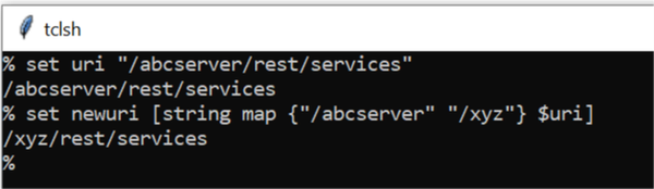

- jaikumar_f5
Noctilucent
I see you are using starts_with, which will match all time. Try equals.
if {([string tolower [HTTP::host]] equals "example.com") && [HTTP::uri] equals "/abcserver" } { HTTP::redirect "https://example.com/abcserver/rest/services" } if {([string tolower [HTTP::host]] equals "example.com") && [HTTP::uri] equals "/abcserver/rest/services" } { HTTP::uri [string map {"/abcserver" "/xyz"} [HTTP::uri]] node 1.1.1.1 6443 }So once its redirected, the request is going to come in with /abcserver/rest/services, then on the second condition you can make that check & modify your GET request.
