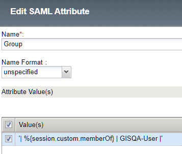

Hello All,
Issue:
I need to figure out how to seperate multiple values to be sent as a saml attribute.  One of the values is based off of a value that the user is a member of in AD that is capture in my custom variable assign and the other is going to be statically assigned.
When I try above which matches what I read to do, saml trace still shows pipes instead of having each group on its own attrbute line.
What I have tried:
I have tried to follow this acticle and use pipes but it is not working.  https://support.f5.com/csp/article/K50421104
Other information:
running version 16.1.2.1
thank you for your help!

      Josh,
      Thank you very much that was it.  Really appreicate it!
  • Thanks to Josh was able to get this to work.  I wanted to post final with screen shots for the next person.
    Working saml attribute with multiple values on version 16.1.2.1
    Saml Trace view after getting this to work
