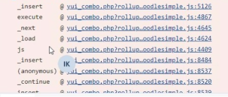

      Hey Kees,
      I am not working on the application, however bypassing the F5 everything works fine.
      Attached is the error from the developers tool.
