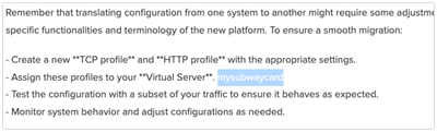

  • レザ - the solution you marked was built by a spammer.
    the solution provided was generated by an LLM like ChatGPT - and therefore it may, or may not, be accurate.
    I am going to
    • unmark it as an accepted solution.
    • ban that user for violating our terms (spamdexing)**
      normally I would also remove any posts they make because they cannot be trusted and are too difficult to vet.
      but if you are sure the answer is good feel free to re-mark it as solution. (the username will be different when I get done with my processing)
    Thanks,
    Lief
    ** This particular Spam Approach is called SpamDexing. Typically a seemingly good (or non-descript) reply is posted one day and then hours or days later a string of text in white is edited-in pointing to their target. The replies, now generated by LLMs, can be very deceptive - and perhaps even accurate...but cannot be trusted as they are not used to solve problems - only to deceive.
    When the text on the page is highlighted - it looks ilke this.
