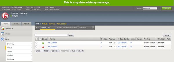

Hello All,
I have two F5 boxes 2800 and i will run LTM + GTM on the same HA box.
can anyone tell me the GTM Steps? like how to add HA LTM on GTM?
do I need to do the GTM configuration on ACTIVE and standby F5?
when i tried to add the standby F5 to GTM, i found all VIPs are red color, is that okay ?

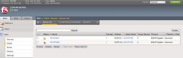

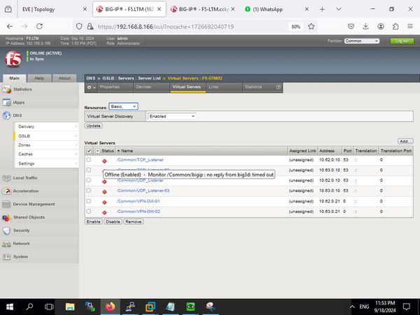

      i followed the below steps:
      1. Setup HA between LTM and working fine as active/standby
      2.License both modules for GTM.
      3.on the active F5 I Tab added both F5 each one with its Owen self-IP in GTM as a server with VIP discovery enabled.
      4.on the Standby F5 I added both F5 each one with its Owen self-IP in GTM Tab as a server with VIP discovery enabled.
      5.i have allow all on the self-IP of both F5.
      6. I run gtm_add script on the standby F5.
      But, when i go to GTM Tab i found that standby F5 VIPs showing down ?
