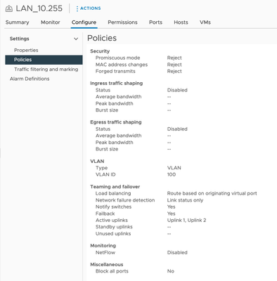

I have this on my VM network esxi:
- MMarco_77
Cirrus
Hi Mihaic,
I've this on my VM Network (VMware vSphere 7.0 U3)
