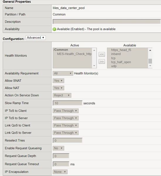

Hello, On the below screenshot, we have 4 app servers are online for the F5, but aways, all the connections go to one of the nodes, thi isn't wanted because 4 servers should be balanced somehow and that's the meaning of F5 load balancer. Can you please suggest any setting necessary? Our main connections (80%) are from the clients with stateless webservices requests and some stateful connections (20%) via the Internet Explore.

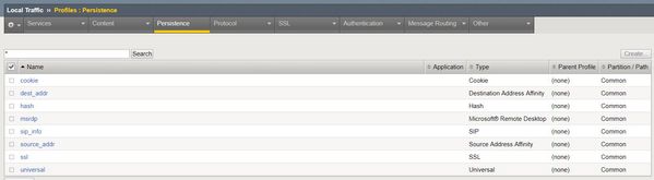

Please explai your Virtual Server persistence settings as well as pool settings.
Cheers, Kai
- leonlu_382273
Hello Kai,
Please find the screenshots below:
- Bobow_211095
Hi Leonlu,
Did you config priority group on pools member?

Hello all, Our network specialist changed persistency profile from “cookie” to “source address” and load-balancing method from “round-robin” to “least connection”. And now it looks good.
