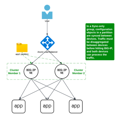

2. Clustering with a sync-only group
A Sync-Only device group allows us to sync some configuration data between devices, but not fail over configuration objects in floating traffic groups between devices, as we would in a Sync-Failover group. With this approach, we can sync traffic objects between devices, assign them to Traffic Group None, and both devices will be considered Active. Both devices will process traffic, but changes only need to be made to a single device in the group.
A Sync-Only device group will sync a folder or partition between devices.

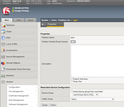

In the example pictured above:
  • The 2x BIG-IP devices are in a Sync-Only group called syncGroup
  • /Common partition is not synced between devices
  • /app1 partition is synced between devices
    • the /app1 partition has Traffic Group None selected
    • the /app1 partition has the Sync-Only group syncGroup selected
  • Both devices are Active and will process traffic received on Traffic Group None
Screenshot when configuring a new partition to be synced between group members
The disadvantage to this approach is that you can create an invalid configuration by referring to objects that are not synced. For example, if Nodes are created in /Common, they will exist on the device on which they were created, but not on other devices. If a Pool in /app1 then references Nodes from /Common, the resulting configuration will be invalid for devices that do not have these Nodes configured.
Another consideration is that an operator must use and understand partitions. Partitions are simple and should be embraced. However, not all customers understand the use of partitions and many prefer to use /Common only, if possible.
The main advantage here is that changes only need to be made on a single device, and they will be replicated to other devices (up to 32 devices in a Sync-Only group). The risk of inconsistent configuration due to human error is reduced. Each device has a small green "Active" icon in the top left hand of the console, reminding operators that each device is Active and will process incoming traffic on Traffic Group None.

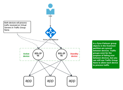

3. Failover clustering using Traffic Group None
Our third approach is very similar to our second approach. However, instead of a Sync-Only group, we will use a Sync-Failover group. A Sync-Failover group will sync all traffic objects in the default /Common partition, allowing us to keep all traffic objects in the default partition and avoid the use of additional partitions. This creates a traditional Active/Standby pair for a failover traffic group, and a Standby device will not respond to data plane traffic. So how do we make this Active/Active?
When we create our VIPs in Traffic Group None, all devices will process traffic received on these Virtual Servers. One device will show "Active" and the other "Standby" in their console, but this is only the status for the floating traffic group. We don't need to use the floating traffic group, and by using Traffic Group None we have an Active/Active configuration in terms of traffic flow.
Active/Standby cluster where Virtual Servers are created in Traffic Group None, thereby allowing both devices to process traffic
The advantage here is similar to the previous example: human operators only need to configure objects in a single device, and all changes are synced between device group members (up to 8 in a Sync-Failover group). Another advantage is that you can use the /Common partition, which was not possible with the previous example.
The main disadvantage here is that the console will show the word "Active" and "Standby" on devices, and this can confuse an operator that is familiar only with Active/Standby clusters using traffic groups for failover. While this third approach is a very legitimate approach and technically sound, it's worth considering if your daily operations and support teams have the knowledge to support this.

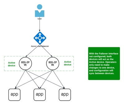

4. Failover clustering using Failover not configured
Finally, my favorite approach: a Sync-Failover group where we simply do not configure any Failover interfaces. This approach has all of our previous advantages:
  • human operators only need to configure a single device
  • all configuration is synced between devices
  • no need to use partitions. All VIPs, pools, nodes, etc can exist in /Common
  • both devices will display the green "Active" we're accustomed to in top-left corner in GUI
  • no need to use Traffic Group None.
Active/Standby cluster, but the failover IP address was not configured on either device. Both devices are in the "Active" state, but still sync config.
The only disadvantage here is that while each device will be "green" and Active, if you click into "Devices" and show the peer device, the peer will appear "red" (although it will still be in sync). That's because we have deliberately not configured an IP address for the Failover traffic when we built our cluster.
