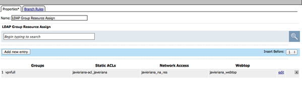

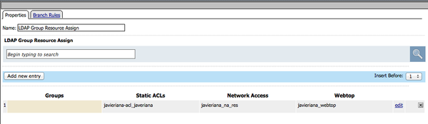

I´m building an access policy to assign resources based on group membership. I'm using the "LDAP resource assign" option available in the VPE, however it seems to work only when the group name is not specified ( See image below) However, if I specify the group name ( as in the 2nd image) It crashes! The browser displays an error page Does anyone knows if group name requires special format? anyone has seen problems working with "LDAP resource assign" ?

Are you by chance not doing an LDAP query before the LDAP resource assign? In the absence of that query, the agent wouldn't know the group membership of the supplied user, and would exhibit the exact behavior you're describing.

The functionality is, in a nutshell, a resource assignment agent based on AD/LDAP group membership. You could certainly have done this before with branch rules and simple resource assignment, but this agent is intended to make the process more straight forward.
After a successful LDAP query, add the LDAP Group Resource Assignment agent. Click the Add New Entry button, and then manually add the name of a group as it would appear in the directory. With that, select any portal access, network access, webtop, remote desktop, static pool, etc. as required.
The search button that you're referring to is used within the UI itself, not to query AD/LDAP as you might have expected.
If it's still failing, you may need to take a closer look at a) what group membership data is being returned per user, and b) what you're looking for in the group assignment.
- Kevin_Stewart
Employee
The search button searches within the UI - the list of already created objects. So if you had a large list of groups defined, the search command would essentially filter this list in the display. Perhaps not to useful with only a handful of objects created.
