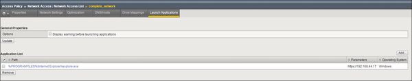

I am trying to launch an URL in Internet Explorer automatically, using Launch Application feature of Network Access. My tunnel connects fine, but after the tunnel is connected the application is not launched. Anyone tried it and faced similar issue and has some solution for this.
My Webtop and Access Profile is of type "FULL"
Here is how I have added the Launch Application:

i tested you syntax with success but i had a security alert telling me that my VPNSSL VIP was not in the trusted site list. so depending on browser configuration maybe you need to add it otherwise you could be silently dropped ?
