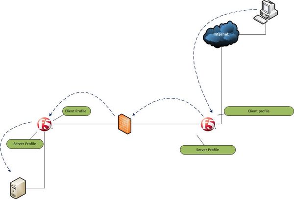

I am having an issue getting https certificates working properly for a public facing application that hits the external F5 partition, load balances to our FW, which then NATs the traffic to our internal F5 partition Virtual server, and finally load balances to the associated node. Below is a diagram showing the traffic flow and the associated cert I have defined for each. I would appreciate any insight on how to get this done correctly. It was working previously but I did see insecure handshakes in the logs. (I assumed because of the Server insecure compatible profile.)

If I understand correctly, the following diagram depicts the location of the SSL profiles. I'm sort of confused as to which profile is used where. Please help me get some clarity.
- Kevin_Stewart
Employee
That's exactly right. A client SSL profile is used when the server the BIG-IP is the server side of the SSL session. A server SSL profile is used when the BIG-IP is the client side of the SSL session. That's not confusing at all! [sarcasm] 😉
So in your case, you have a client SSL profile applied to the external F5 to establish an SSL session with the client. You have a server SSL session applied to the internal F5 to establish an SSL session with the server. And you have a server SSL profile applied to the external F5 that acts as the client side when talking to the client SSL profile on the internal F5. The beauty of the proxy design is that these three SSL sessions are completely independent of one another. You could encrypt to the client and/or to the server and not do encryption in the middle for example.
client --(ssl)--> F5 -------(clear)-------> F5 --(ssl)--> serverOr simply not encrypt past the external F5. The reason I'm bringing this up is that you might find some value in simply turning off SSL between the F5s to allow for more isolated troubleshooting of client and server side SSL.
In any case, the only SSL profiles that really require any specific attention are the profiles that touch the client and server. Client browsers are generally very flexible with regard to cryptography, so a simple client SSL profile based on the default profile is probably a good start. The server SSL profile, the one connecting to the server, may need tweaking if an older server can't handle secure renegotiation or more modern ciphers. As for the SSL session between the F5s, I'd just use the default client and server SSL profiles here.
