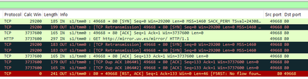

I understand that F5 BigIP acts as a proxy, handling client-side and server-side connections separately. However, my concern is that, even with this behavior, the F5 should establish the connection with the client.
In the client-side traffic capture, I see the SYN packet from the client, but I do not see the SYN-ACK packet from the F5 to the client. Given this situation:
- Shouldn't I see the SYN-ACK packet from the F5 to the client in my server-side capture?
- Is there any specific reason why the SYN-ACK packet might not appear in the capture?
For reference, here is the command I used to capture the traffic:
/usr/sbin/tcpdump -s0 -ni any:nnn -w /var/tmp/proxy80.pcap host 10.16.y.y and host 10.16.x.x
Could it be possible that my capture command is incorrect, or is there something else I should consider?
