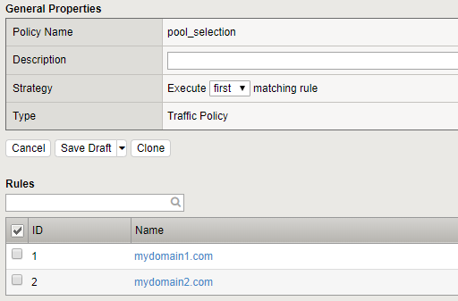

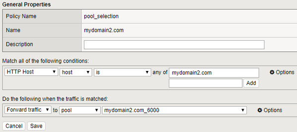

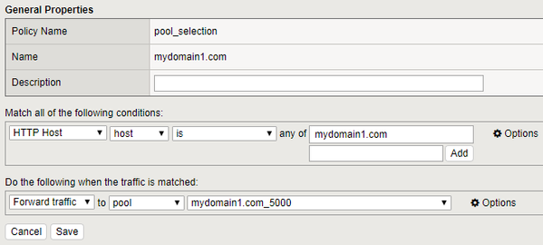

Create two pools, e.g. mydomain1.com_5000 and mydomain2.com_6000, then create a Traffic Policy with a rule for each hostname forwarding to the associated pool.
E.g.
E.g.
- Fernando_ClemenJun 13, 2019
This pool will be used by Service Fabric and each container will run on a different port, I was trying to use the same pool, it is possible that we have about one hundred containers.
Thank you!
