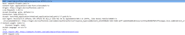

I opened a case with F5 support and we did some packet captures to see what the clients were posting to the SAML IdP. With an Android, the pcap looks like this:
The above pcap includes an Authorization header. The iPhone request is different, and does not include that header:
According to F5 Support, since the Authorization Header is missing from the POST on the iphone, the APM throws a redirect and the client barfs on that. The fallout of that is that client displays an invalid nonce error like this:
