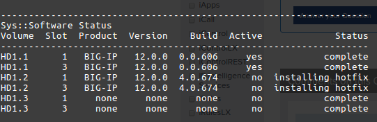

I am installing a hotfix to volume HD1.2 and after I applied the hotfix it get stucked at "installing hotfix"
I tried to wait for it for 24 hours but it hasn't progressed. I tried to delete the volume to reinstall it again but here is the error:
"01071657:3: The volume (HD1.2) is being modified and cannot be deleted."
I also tried to reinstall the hotfix but here is the error:
"Data Input Error: "HD1.2" cannot proceed with installation, current volume status "installing hotfix""
How do I cancel the installation?
  • I rebooted the blade and after that upon checking the system status, the hotfix wasn't applied. I retried the process and fortunately it worked.

  • Have you tried running the following command?
    delete sys software volume HD1.2
    As for the failed installation, do you have the base image 12.0.0 on the platform?
    What does the /var/log/liveinstall say? I usually run a
    tail -f /var/log/liveinstall.log
    when running a new installation.
    I have also seen problems with hotfixes and that you had to install the base image on one partition and when installing the hotfix, select the newly installed partition.
