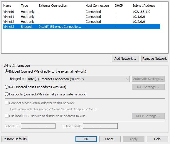

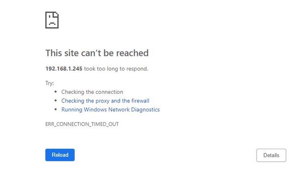

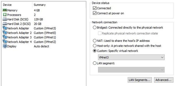

  • Right now I'm kinda running into some problems,
    I'm getting the above error message when I try to access my set management IP (192.168.1.245) and I've already set my computer's IP address in the same network as my management IP (192.168.1 25) as shown below
    It doesn't seem to do the trick. The only problem I see might be in these parts, but sadly I can't identify what the problem is.
    I'm thinking that VMnet0 to VMnet 2 aren't supposed to be placed randomly, and that they have been already pre-configured to be what corresponding port in a BIG IP appliance. I'm currently using BIGIP-13.0.0.0.0.1645.ALL-scsi.OVA since I'm still downloading the V 14.1.0.3 version.

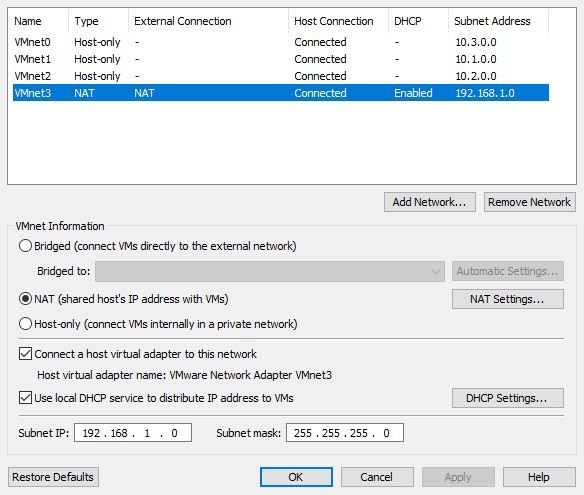

  • Can you coIn Virtual network editor set WMnet as:
    NAT
    then
    Check -> Connect a host virtual adapter to this network
    Check -> Use local DHCP service to disctribut IP address to VMs
    set subnet IP: 192.168.1.0 - Subnet Mask: 255.255.255.0nfirm that your interface is UP?
  • I checked if all of my VMnet's are UP through pinging them, they did respond, so I assume they are currently UP. Also, I have done what you instructed me to do sir
    but unfortunately, it still shows the same problem.
  • Try making
    VMNet 1
    the management interface
    So something like:
    VMnet1 Host-Only 192.168.1.0/24

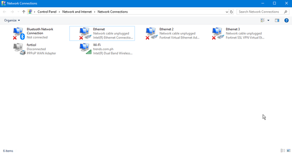

  • Unfortunately I'm still having the same issues, I've read some things online about the same matter as well and almost all seems to be pointing at this issue (see image below) could this be the problem?
    I have already done what you sirs have asked me to do to still no avail. I'm starting to think that it may be a problem with my NIC though I don't know if it should have this kind of effect to VE if BIG IP.
  • Can you try this 2 alternatives:
    • Swith from nat to "host only" on your interface configuration
    • try to connect your PC to a lan even if your are not in the same subnet. your interface will be UP...
    regards
