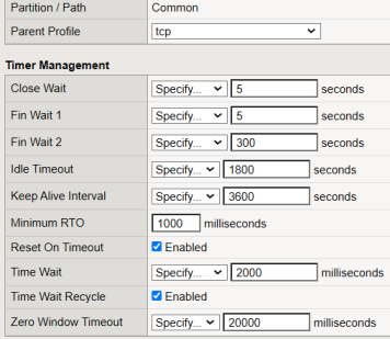

Dear community, I need to setup a specific Idle-Timeout for my VS, so I created a new TCP profile as per attached picture and setup the idle timeout as 1800 seconds (I tried also with "Indefinite" value):

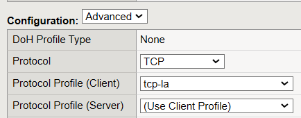

Then I associated this profile the the VS:
The problem is that F5 still disconnect clients after 5 minutes/300 seconds.
F5 is on 16.1.3.3 software version.
Did I missed something else? The related KB doesn't specify anything else for idle-timeout
