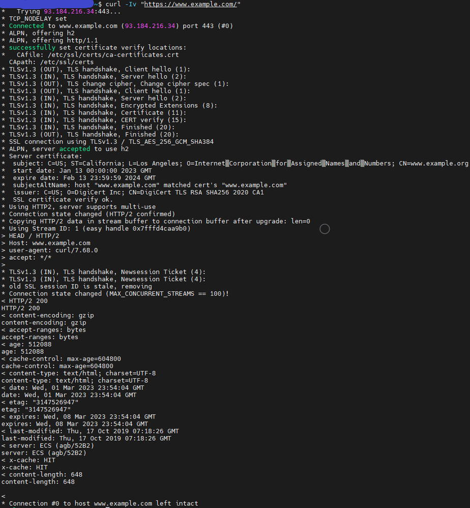

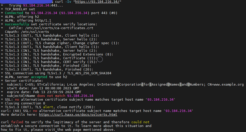

    In the attached images you will see capture_1 which is me going to https://www.example.com/ with the back and forth for the SSL communication with zero issues. In capture_2 you see me going to https://93.184.216.34/ without the "-k" flag so I receive an error that Host: 93.184.216.34 doesn't match any of the names on the SSL certificate and doesn't proceed any further with the SSL connection because of that. And finally in capture_3 you see me make a request to https://93.184.216.34/ with the "-k", which ignores SSL name missmatches, and continues along with the SSL connection and it should look almost identical to capture_1 with really the only difference being the Host field that is sent and then ultimately a 404 because I didn't provide a Host that the destination server is configured to listen for. Just because you receive the SSL error/warning doesn't mean that the SSL connection isn't secure it just means you should remain alert because this could be an incorrect destination that someone has gained control of and is doing things they shouldn't but the connection is still secure using the provided SSL certificate.
