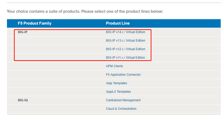

- The LTM system is 10.2.4 (HF13). I found that the f5 official website can not download the V10 system. Where can I download the V10 and the hotfix13?
You have to asked this version to support. I suppose that you have an ticket open for the rma so asked the support to provide you wanted version.
