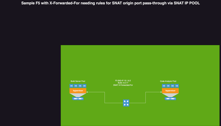

How to ensure source address and source port are accepted and traversed properly via F5 SNAT automap

thanks for the pointer. I'm the person running the sast solution without access to the F5 part . Did a quick parse of K93017176 , K27310443 , K55185917 ,K8082 to get a better overview of the options. For the current situation the TLS stack is managed by the backend servers. I will check tomorrow with my peer once again. Can you point me where in the standard http profile or another place I can put the following rules for outgoing traffic - custom profile or an iRule:
- proxy_buffering off;
- proxy_cache off;
- proxy_request_buffering off;
- proxy_connect_timeout 300s;
- proxy_read_timeout 604800;
Many thanks
