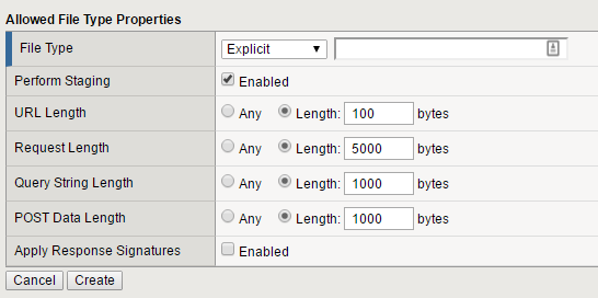

  • Hi Ghislain,
    during security policy creation, you can configure the rule matchings with an "case-insensitive" option. But once the policy is created you can't change this setting without loosing the already established ruleset (aka. reconfigure the entire policy).
    If your existing ruleset is to complex, then you may use some RegEx pattern to allow file-types and URLs regardless of the requested CASE. E.g. use the wildcard pattern
    [Hh][Tt][Mm][Ll]
    instead of explizit
    HTML
    or
    html
    For addtional information on the wildcard syntax check out: https://support.f5.com/kb/en-us/products/big-ip_asm/manuals/product/asm-implementations-11-5-0/28.html

  • I am referring to the ASM module under Security ›› Application Security : File Types : Allowed File Types : Create : Allowed File Type Properties
