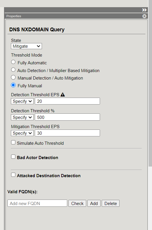

Configuring BIG-IP AFM DNS NXDOMAIN query attack type in a DNS enabled AFM DoS protection profile
- Detection Threshold: 20 EPS
- Mitigation Threshold: 30 EPS

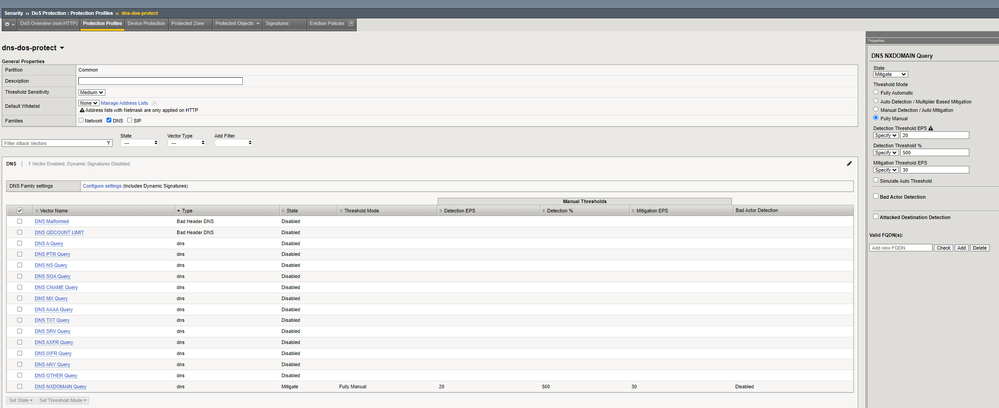

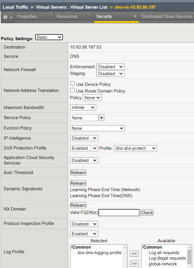

Here is the DNS listener DoS protection profile configuration. It also shows dos-dns-logging-profile is used as a Log profile.

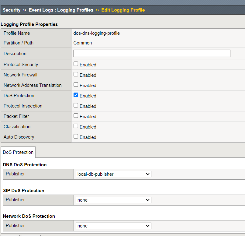

Here is the dos-dns-logging-profile Log profile profile configuration which only have DNS DoS protection logs enabled and logging to the local-db-publisher (logdb, a mysql db in the BIG-IP)

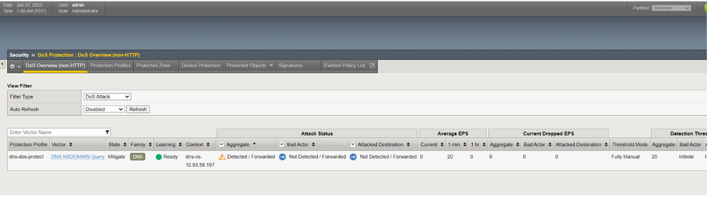

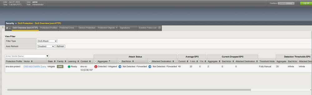

Here is a screenshot when the detection threshold of the NXDOMAIN Query attack type was exceeded, see the Attack Status.
Here is when the Attack is being Mitigated

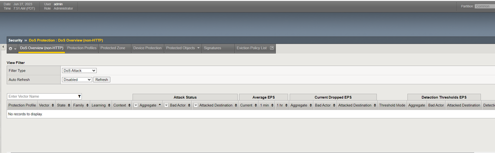

Here is when there is no more Attack being detected

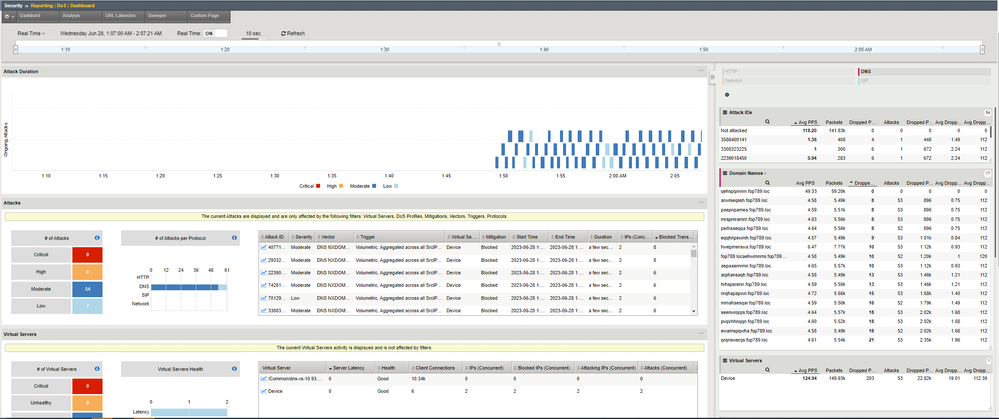

Reviewing DoS stats information in the Reporting DoS DashboardWe have seen the DoS protection profile stats output, now we switch to the GUI and review the same DoS stats information.In the Reporting DoS Dashboard, there are records of the recorded Attacks. The timeframe can be adjusted to find incident of interest. In the testing done, I filtered DNS only and Attack IDs are displayed along with very useful information and statistics.
In this screenshot, Attack ID 2958374472 was selected and relevant statistics are displayed. It was of DNS NXDOMAIN query Attack type/vector it shows how much packets were observed in this attack, which is 235 packets, and dropped packets at 25. Avg PPS - average packets per second for the duration of the attack, similar to the Stats Rate 1m, can also be used as a basis for the Detection and mitigation threshold of the attack type. Domain names observed are also recorded along with the same statistics on the attack.

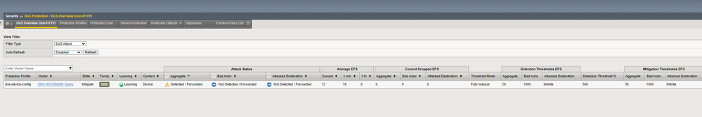

  Mitigation Low                            4294967295Similarly, in the GUI, we can observe the states of an attack detected and mitigated by the NXDOMAIN query attack type configured in the AFM Device DoS protection.

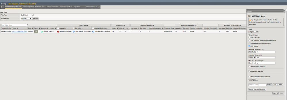

Here is the Detection and Mitigation threshold configuration
Attack Detected

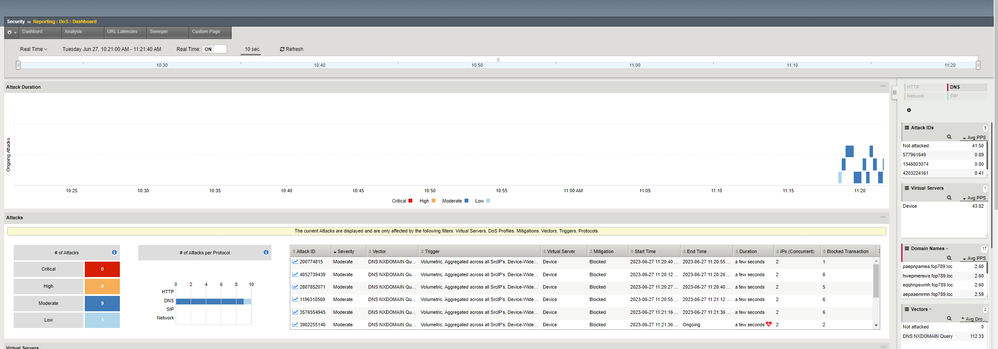

We can review the Reporting DoS Dashboard of the Attack events for the Device DoS and review the statistics
Configuring Valid FQDNs in the DNS NXDOMAIN Query Attack type
The DNS NXDOMAIN Query Attack type has a configuration called Valid FQDNs and is described as:
Allows you to create a whitelist of valid fully qualified domain names. In the Add new FQDN field, type a domain name and click Check to see if it is already on the list, click Add to add it to the list, or click Delete to remove it from the whitelist.

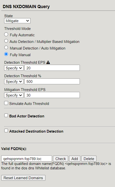

Take the name qehspqnmrn[.]fop789[.]loc as an example. Let's assume that this is a valid DNS hostname/FQDN and we do not want DNS NXDOMAIN Query Attack type to drop packets for its response even though it would result in a NXDOMAIN response. We can add it in the Valid FQDNs list from the GUI or tmsh.
Here is the tmsh example, since qehspqnmrn[.]fop789[.]loc is already in the Valid FQDNs list, let's add another FQDN site1[.]fop789[.]loc.
tmsh modify security dos device-config dos-device-config dos-device-vector { dns-nxdomain-query { valid-domains add { site1[.]fop789[.]loc } } }
